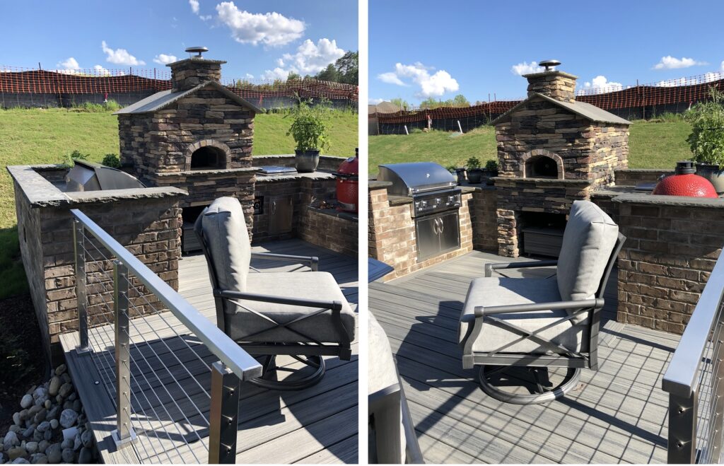

5: Weak Support Structures or Flooring
It’s important to bear in mind that pizza ovens are heavy, especially in the case of larger models with large cooking surfaces.  As such, they require a strong countertop placed on a sturdy and totally flat surface. Surfaces susceptible to movement, e.g. turf, are generally unsuitable.
Customers who want to place pizza ovens on wooden or composite decking will have to check to make sure the decking can handle the weight of the pizza oven. This isn’t typically a problem, especially with smaller to mid-sized units – but even our largest countertop pizza ovens have been installed on decking without any issue. NOTE: Wood decking has fire-clearance criteria detailed in the owner’s manual that need to be followed.
Primavera Outdoor Pizza Oven in Northern IL
Primavera with a non-combustible stone material placed over the decking for safety and easy cleanup.
Note: This deck is made with composite planks (fire-resistant). It is also reinforced on the end to support the weight of a Casa2G80 oven kit, as well as the other kitchen elements.Consideration here extends to the countertop itself. The supporting structure for the pizza oven needs to be strong and durable and should be weather-resistant so it doesn’t weaken over time. Concrete and stone are generally better choices than wood.
Our Cucina Pizza Stands are super-strong, steel, modular stands designed and built for our modular home kits. They can be finished with a variety of materials, and are well worth considering if you want a pizza stand that looks great and is guaranteed to handle the weight, but are less work than building a cinderblock stand.
Note: Sturdy cinderblock base on reinforced concrete pad. A stone facing was added afterward.
