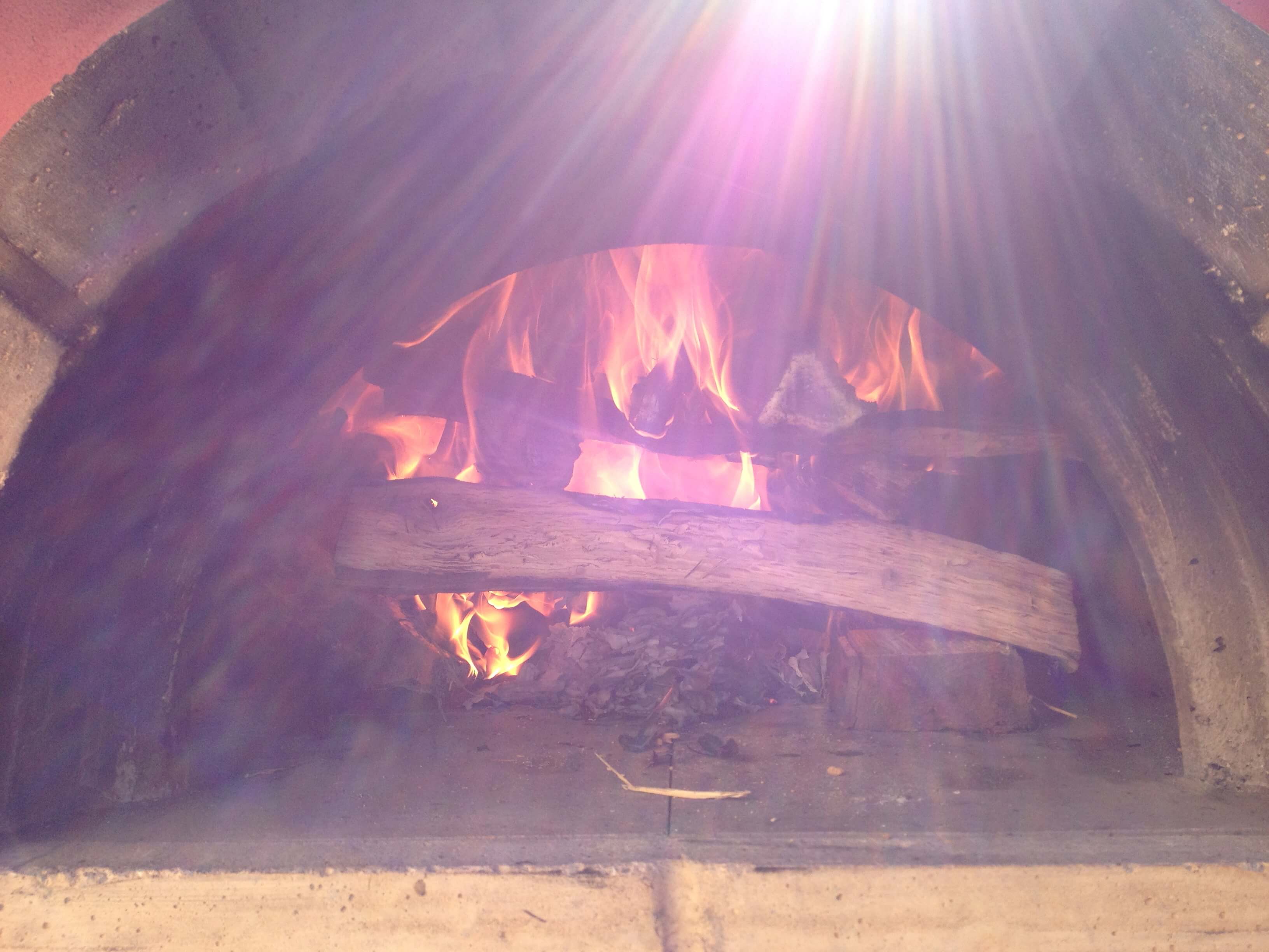

Check out the picture below in my small Strata60 oven. By stacking the wood all the way to the top of the oven dome, I was able to easily bake three loaves of bread and still had a lot of heat left for other baking. It took about two pieces of ordinary firewood.

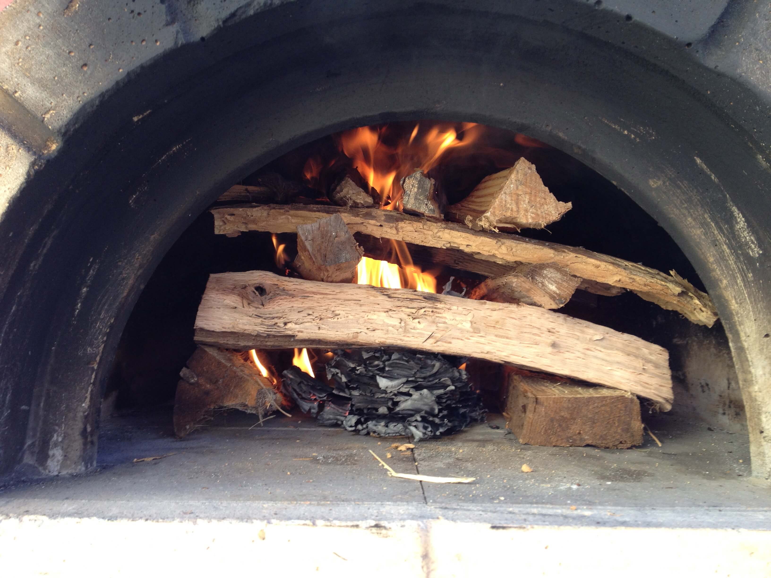

Please forgive the next bad photo. But it reinforces the idea that you don’t have to do anything after you stack and light your fire. All of wood catches fire, so you can just walk away. After all (or at least most) of the wood have fully burned, you close the door on the oven openingĀ and wait for the temperature to regulate to the bread baking or roasting temperature that you want. This is easier than a Weber!
