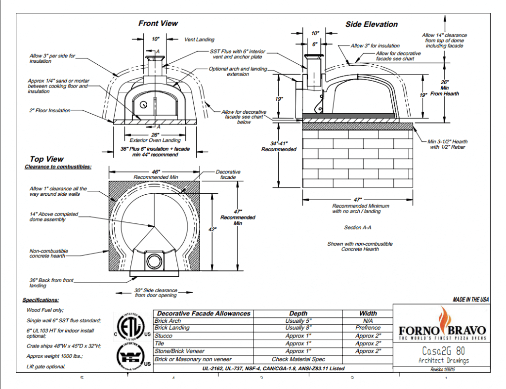

For a quick peek, check out the Casa 90 print.Screen Shot 2015-02-20 at 6.32.53 PM
Key improvements include:
  • A nice clean visual of the Front, Side and Top view of the oven with all the installed components layered.  This came from all our customers suggestions;
  • We added the minimum recommended footprint for the installation.  This assumes that your pizza oven install is going to use stucco and not a thick structure to enclose it.  Thank you to Home Pizzeria Ovens of Florida / New Hampshire for that suggestion.
  • Insulation and Flue specifications are clearly identified.
  • Ship weight and crate size are listed in the bottom left to make planning for a delivery easier courtesy of Outdoor Pizza Ovens in Canada.
  • Minimum clearances to combustibles are clearly identified in the top view thanks to The Arch in North Carolina;
  • Hearth specification is listed for convenience so you don’t have to refer to the install guide when planning;
  • A Decorative Facade Allowances chart is included to give you an estimate on how different appearances may increase your footprint.
