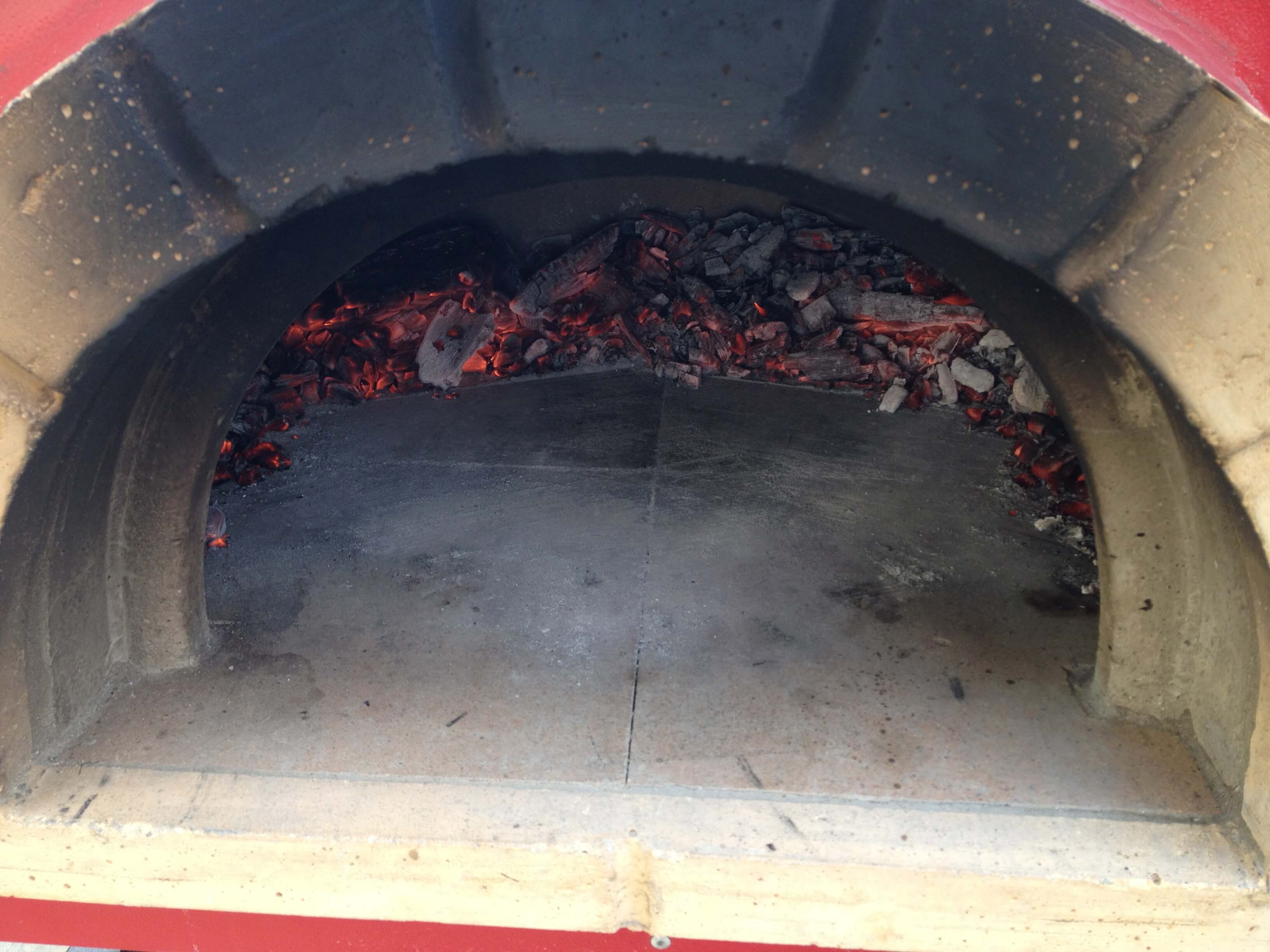

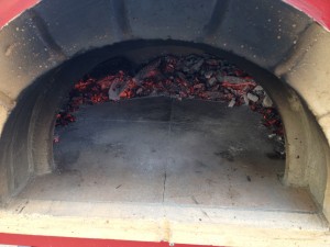

I’ve been working with my prototype Presto oven (though we are going to be changing the name when we introduce the product) and I am really getting to know it. One of the issues I am working on with my new oven is balancing dome and floor heat. Unlike a larger oven, where the challenge can, at times, be keeping the cooking floor hot, in a smaller oven, because the fire itself spreads over a larger part of the cooking floor, I am finding that the floor is hotter than the dome.
To address this situation, I have started raking the coals toward the outside of the floor after the fire burns down. I keep the heat in the oven, without overheating the center of the cooking floor — where it can burn the bottom of my bread.
If you have trouble with your dishes cooking faster on the bottom than the top, you can try this technique.
