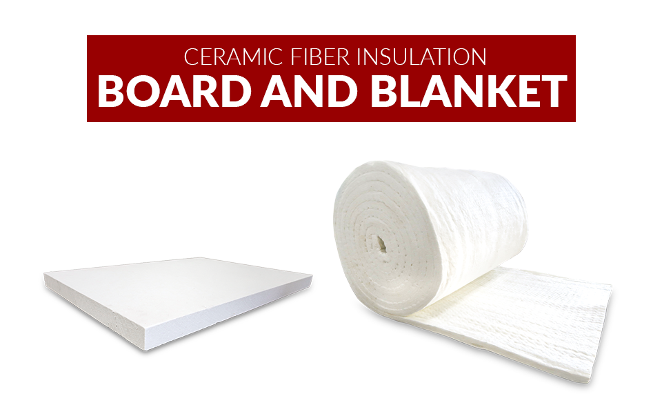

So, lay down an insulator underneath your oven. We use use Alumina Silicate boards which is about twice as efficient as Vermiculite and Portlant cement mixes.
2. Skipping the DOME Insulation
Just a quick tip: your dome needs insulation too! We’ve seen lots of builds over the years where folks skipped it, thinking it wasn’t a big deal. But without insulation, the oven can’t get hot enough to bake properly. A few people even had to rebuild, so it’s definitely worth doing right the first time!

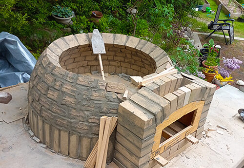

3. Using the Wrong Materials Instead of Firebricks and High Temp Mortar
Red clay bricks or concrete blocks can’t handle thermal expansion. They’ll eventually crack. Also, regular mortar or Portland cement breaks down under high heat, causing air leaks.

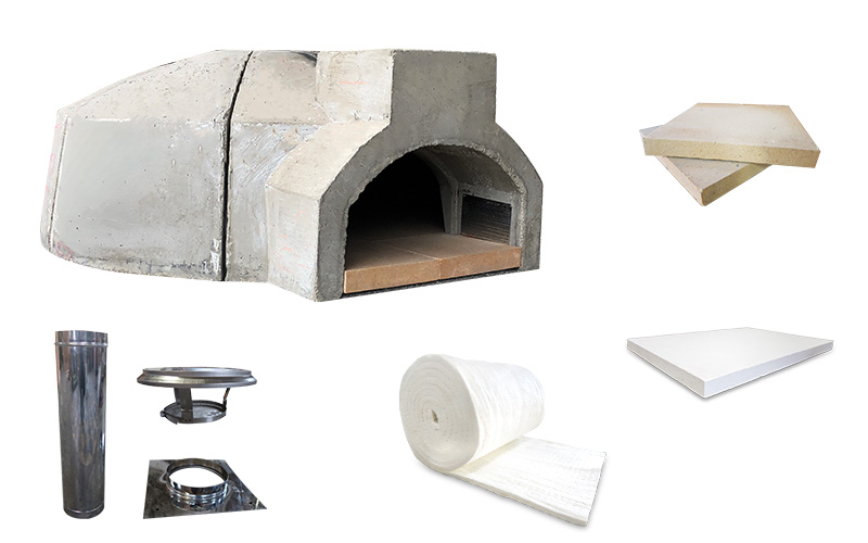

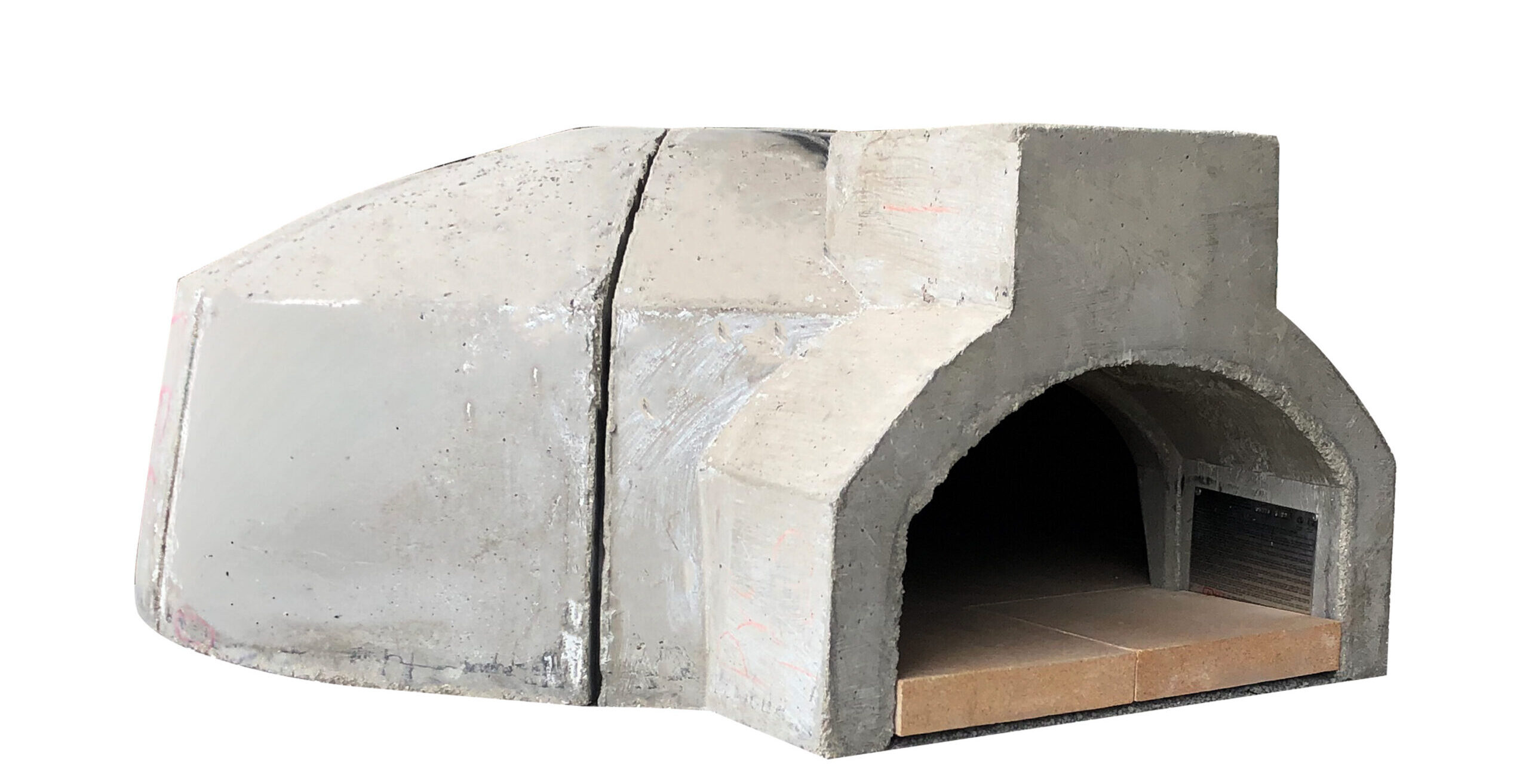

That’s why we always recommend using firebricks and high-temp mortar. Or better yet, go with our CASA dome kit, which already includes the right high-temp materials for the job.

4. Poor Dome Shape
We’ve seen squares, triangle-like shapes, and outright super wide interiors, that keeps the ambient temperature from going up. Flat domes cause poor circulation and uneven heat reflection. On other hand, overly tall domes require longer heating time and waste wood.

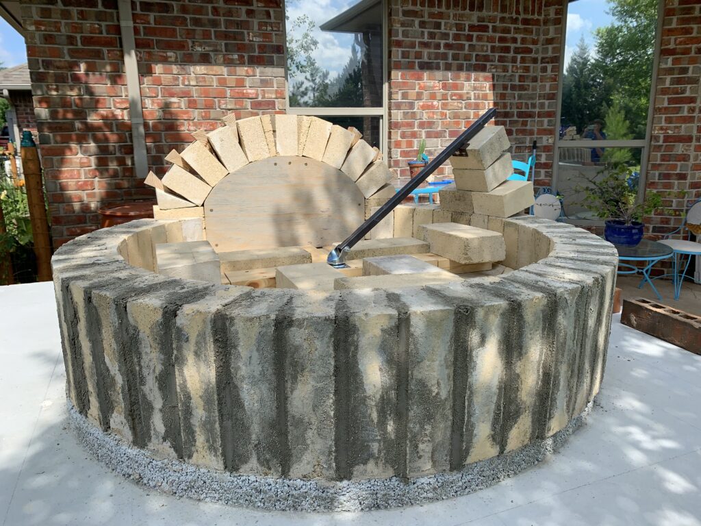

5. Uneven or Weak Foundation
A base that flexes or cracks under the oven leads to structural gaps where heat escapes.
Use a reinforced concrete slab, level and cured before building.
