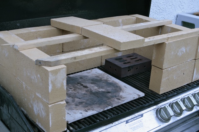

And so, I too was inspired. I started playing with my gas grill and wood fire idea and wondered how I could keep the heat in — the lid did, after all, have to open and I would keep losing all that heat. I had a few bricks laying around so I started laying them out on the grill. Hmmmm?When I got back from the building supply yard and carried my newly acquired fire bricks to the back yard, I started stacking my bricks to see what I could build. I cut some wood to figure out how I could make a roof for this thing. I tried a number of configurations. It took another trip to the building supply and then a trip to the hardware store for some steel to replace my wood supports, but I ended up with what looked like a brick block oven. I spent less than $50 (not counting my pizza stone and wood – smoker box, and the grill of course!). But, would it work? It looked like it should.
The idea was that my grill, when turned on, would crank out it’s 550-600 degrees of heat. Then, the pile of wood would add more heat and the brick enclosure would hold onto it all, radiating it back onto my pizza. Seems simple, right?!I realized that my door opening was losing way too much heat as I fired this contraption up. I had a few left over bricks that I tried to wedge in the doorway to help contain the heat. That was quite a lot of fun, as I had to move and adjust these hot bricks and balance them precariously on the edge of the grill. But, it’s what I had, and this was a project in my own personal pizza quest, so it was all part of the fun. After all, I’ve often written here that one of the best things about pizza is the “fun” and this is another example where you can have fun with your techniques as well as with the ingredients.

There wasn’t much happening! I stuck my hand in the oven – not too hot. My door design seemed to be letting too much heat out. I had built another version with a lower door, maybe that would have worked to hold the heat from rolling out? Maybe I could add a second wood burning box? The pizza cooked. It cooked slowly – slower than in my home oven. I failed! I couldn’t figure out how the simple stainless grill cover seemed to keep the heat in the grill oven better than my brick oven enclosure.

I had a random thought. I wonder how much of the problem might be the fact that the heat of the oven is not transferred from brick to brick.
In a “real” brick oven you have heat flowing through the mortar between the bricks. In your “just stacked” configuration the conduction between bricks is probably not working out. That leaves you with only convection which is not as efficient.
If you have an infrared thermometer try pointing it at the various bricks and see how much heat they’ve picked up.
Similarly, I wonder how much heat you might be losing through the gaps between the bricks on the top of the oven. Perhaps if you mortared together the bricks that make the crown of the oven (but left the rest of them stackable).
