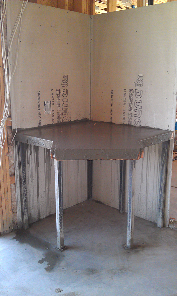

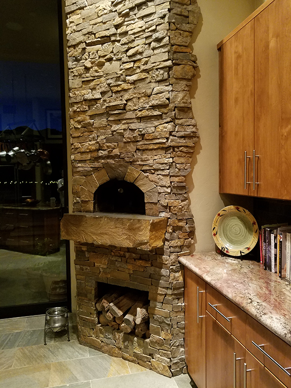

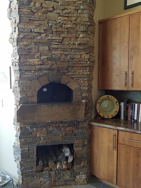

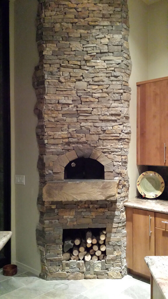

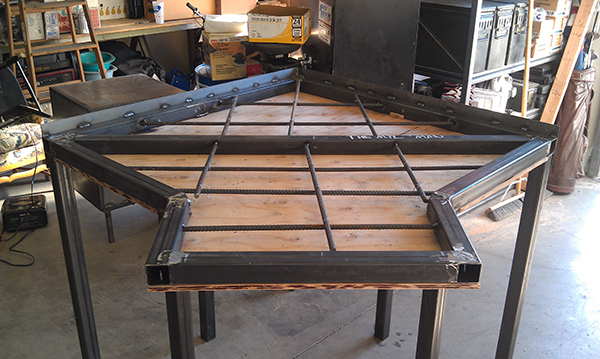

“Build Process: We built the frame from 2″ square tubing, welded it up, then made a 3.5” fence around it, and poured 8 80# bags of concrete into it. Framed it up in the kitchen of the new house we were building, then had the stone masons cover it.
Inspiration: Our inspiration is being able to invite friends over for wood fired pizza. They never say No. Next is mastering baking artisan breads! We use pecan wood almost exclusively. The oven is 7-years old and going strong.”
