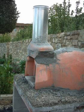

1. Cooking floor level on refractory mortar
2. Cooking floor set on hearth
3. Sealing the chimney interface on the vent
4. The sealed vent

Using refractory mortar and a notched trowel, we set and leveled the oven floor. For anyone who has set ceramic tiles, the task of setting the floor will be very intuitive and familiar. We then assembled the oven dome.
Next, we assembled the oven vent. The vent comes in two pieces so that it can easily accommodate either a concrete/clay chimney or a steel chimney. Our installation used a steel chimney, so we used both the rectangular vent and the round chimney adapter. Using refractory mortar between the oven and the vent pieces, much the way one would lay bricks, we assembled and sealed the vent. We set the round chimney inside the adapter and sealed that piece with refractory mortar. We used additional refractory mortar to seal then entire vent assembly and to ensure that there were no cracks and that smoke could not escape.
It is important to note that we set the vent so that the front of the vent assembly and the front sides of the oven lined up. The notch on the oven vent sits on top of the oven, in order to make the vent assembly lie level. You will attach your decorative arch to the sides of the oven and the front of the vent assembly.
Finally, we sealed the joint where the bottom of the oven met the insulating hearth.
