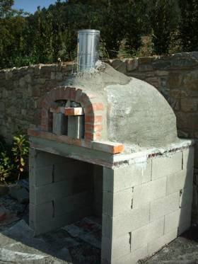

We built both the oven landing and opening from standard red clay bricks. Because we did not have any tools, and we still working on the rapid installation approach, we decided to score the bricks, and break them with a hammer. It worked well.
Also, because we decided to not use expensive tools and forms (as they would be difficult to obtain), we decided to frame the arch opening with blocks, bricks and pieces of brick and block.
Again, it worked well.
We framed the arch using 1/2 bricks, about 4″ deep and set our arch without cutting any angles. The final product is a hearty, rustic look — appropriate for the local Tuscan landscape.
In order to make fully certain that the arch would not fall in, we let the mortar cure around the arch overnight, before removing the forms.
We are now ready to do our last stucco coat and finish the oven.
