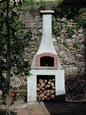

traditional igloo design
1. Traditional Igloo design.
